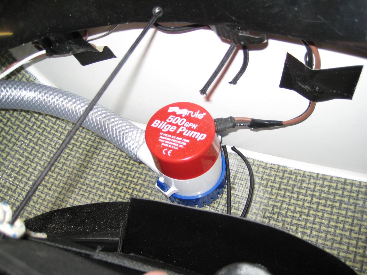

The Rule 500 is still the default choice. There are sophisticated versions that switch on and off automatically but I want manual control so the basic version is fine. I want the pump to be at the lowest point so its located behind the seat. When you need to pump out the dregs a forward stroke or two will slosh them towards the pump. The pump is quickly removable from its base which is glued to the hull by araldite (sand both first).

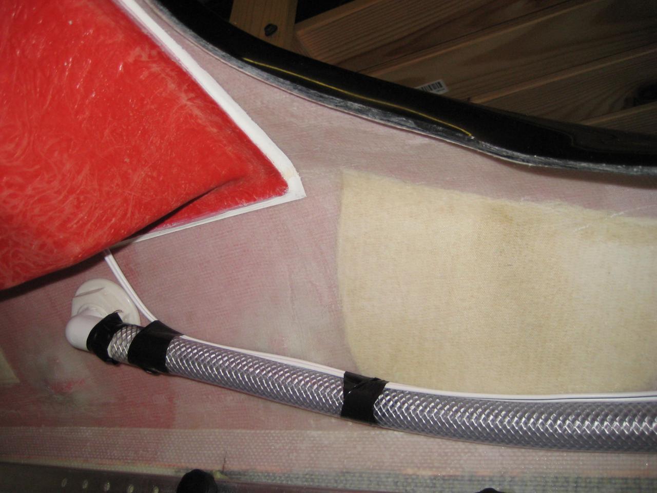

The previous design involved a hose that had to be manoevered out of the cockpit and under the spray deck. This would be too fiddly in a tight situation so this time around it had to be a hole in the boat and a 'skin fitting'. I didn't want to put a hole in the hull around the cockpit region as that is an area of high stress / weak point in the structure of a kayak. I've built the output into the foredeck about 150mm forward of where my right knee fits, ie very visible and within reach. There are many 'skin fittings' on the market; I wanted a 90 degree fitting so that the outlet hose can run to the inside of the hull. Most fittings still protrude away from the hull too much for my liking so I modified the fitting I bought, cutting it short so there is minimum protrusion inside the hull. The other thing I didn't like about the fitting was it involved a constriction down to about 15mm diameter. The hose and pump outlet are 19mm. 'Waste' overflow fittings from plumbers merchants are 21.5mm. The solvent waste 90 degree bend has a considerably larger internal diameter and will allow better flow. When married up to the remains of the commercial skin fitting, the end result is flush, neat and will enable maximum throughput. There was about 0.5mm to make up between the 90 degree bend and the skin fitting, so a bit of insulation tape did the job. 1mm holes drilled in the edge of the nut, plus some corrosion resistant wire wrapping, ensured the 90 degree bend would not come free from the skin fitting. About 30mm of 21.5mm tube was glued into the 90 degree bend and the hose was forced over the tube with some silicon lubricant. The hose is self supporting to where it slots just beneath the cockpit rim and above the seat. It then curves around to the pump. It goes conveniently beneath where the knee touches the hull.

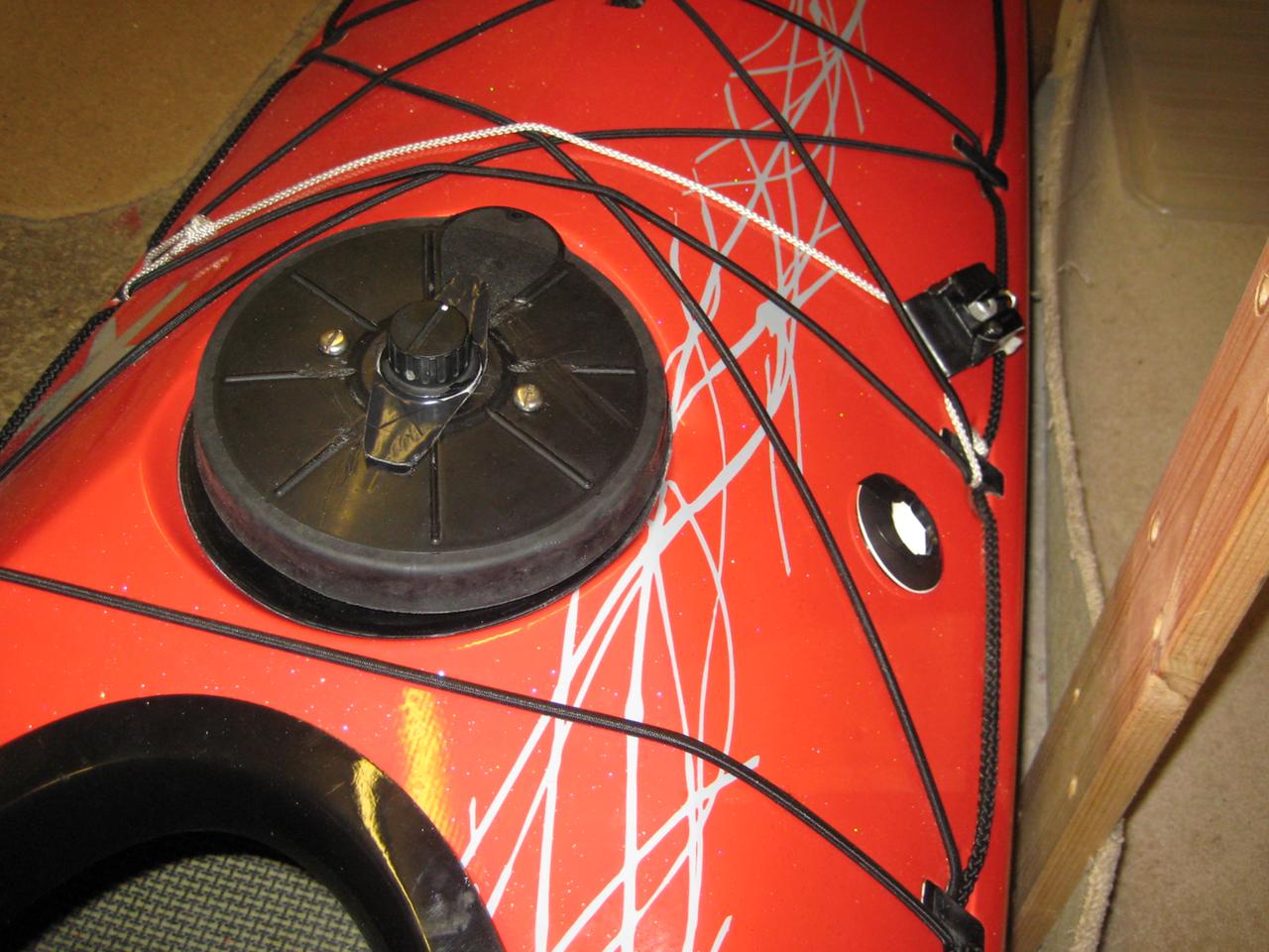

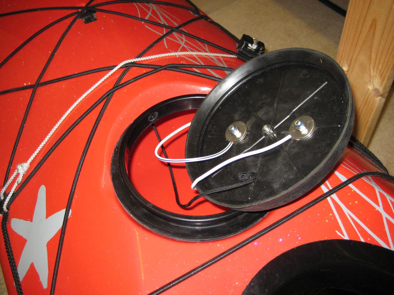

I think this is the trickiest part of the installation. Many different solutions have been implemented. I'm trying another 'blue sky' approach that bears some relation to my previous versions. It's built into the hatch cover of the pod so its directly in view, easy to access and its obvious whether its 'on' or 'off'. The two contacts are formed by the heads of two stainless steel pan head screws that are a tight fit through holes in the cover. The wires are attached to the underside and sandwiched between 'penny washers' (also greased with vaseline). The lever is built from a flat piece of stainless screwed and glued to a Maplins plastic control knob. Rotating clockwise covers both contacts and completes the circuit, anticlockwise breaks the circuit. The leading edge is raised slightly so it rises up over the screw heads easily, and the trailing edges drop down slightly to ensure the lever can't run over the screw heads completely. The only negative (scuse pun) consideration is that sea water conducts electricity but in trials this hasn't proved to be a problem.

Inside view of hose to skin fitting and switch wiring to pod.
Pump in situ.

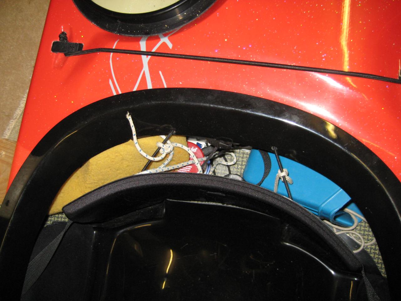

Pump, backup bailer and sponge.
Switch and outlet.
Switch underside.
